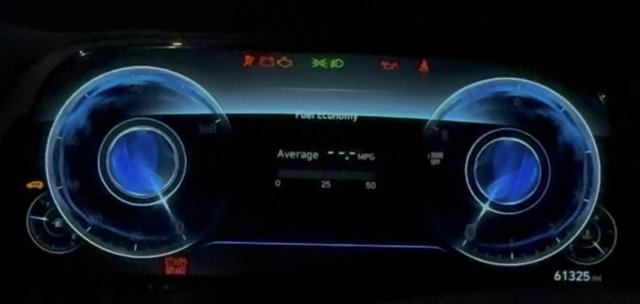

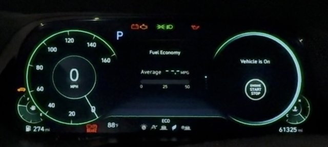

Mine is a 2021 Palisade Calligraphy, too. Three times it has decided not to start when I have the fob inside the vehicle, foot on brake and push the start button. Nothing happens at all. Last night, it was dark and there were no lights on anywhere. I decided maybe the clamp on the terminal may be loose so I opened the door to go check that and when I opened the door, everything lit up. I managed to get a picture of it rebooting and then telling me that the Vehicle is On. HA!

Update: I took the Palisade to an automotive shop for some work and it did it when they went to move it into the shop. Turns out the battery cable was loose. They tightened it. I'm expecting it to be resolved. I'll update again if there are issues again.
